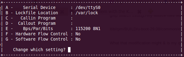

COM Port is not working when I connect my board in this way
I am using minicom, all the necessary drivers have been installed.
When I use Serial Cable I connect with minicom configured like this
573-serial_snap.pngWhen I use USB i use Serial Device as /dev/ttyUSB0 .
When I use a USB to Serial Connector, the board is then working fine, I mean I am able to communicate with my board.
The serial cable and COM Port if used individually are working fine.
Any idea about this problem?

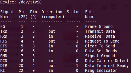

As early mentioned I have been checking the DB9 connector.
Even the statserial software could show the same.
Which means that the COM Port is not receiving any data that is transmitted to it.
Here are the pics of the Stat Serial
I just connected the board, Now the booting sequence has been initiated after Power Up

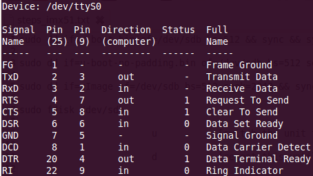

575-statbeforestat.pngNow I need to enter the log-in that is by default root
Any Infererences?
Have any one faced the problem with the COM Ports on the board/PC.    Regards ::  Krishna Pavan
