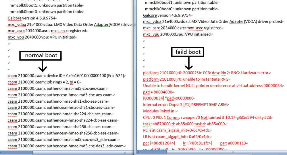

In our  mass product, 3% are defective when boot, the log from serial port shows it shop at CAAM .
please give some help! Thanks

Sorry, how to understand " The RNG Hardware error usually means that the entropy source has
failed to generate entropy
", what handware or software be related to it?

dengboping
It is random , 3  in 86 times  power on happened.
