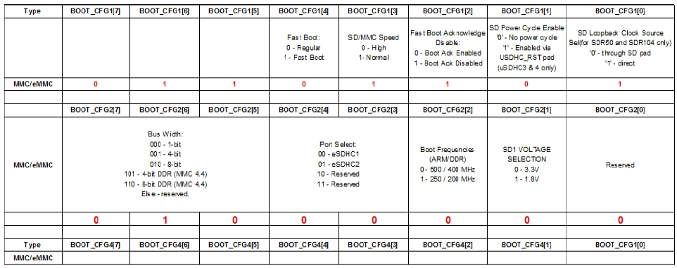

Can any one tell me the the BOOT_CFG setting for configuring the boot through eMMC.
Following configuration I tried to have booting from eMMC. Kindly confirm or suggest the seeting of Boot_CFG.
Red numbers shows my setting where 1 represents Pull up and 0 represents Pull down.

I think settings are correct, note also bus width should be configured in eMMC
Extend CSD register byte[177] bit[0:1].
