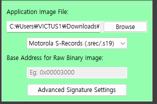

From Boot to SDRAM manual,
Followed to Step 2.
I created an s19 file, and I'm going to follow the guide to execute the sentence below.
"After all these step, you can open MCUBootUtility and download the .s19 file to NOR flash."

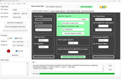

However, I couldn't find the download button or function in the picture below.
anyway,   From https://github.com/JayHeng/NXP-MCUBootUtility?tab=readme-ov-file
First 1. Target setting -> i.mxrt 1020 LQFP 100/144
2.  To connect , Board  dip switch change to  0001 (serial download mode)
and click button  [reconnect],
3.     click browse , and    insert path .s19 file
4.  What I have to do ???  ( For downloading  .s19 file  to   i.mxrt1020 EVK board )
anyway, I Clicked button  [all in one Action]

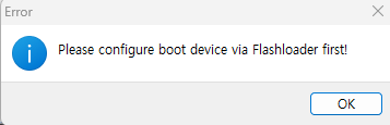

But  Error Box.  Occur
5.    so.. Next  I  read Step 3  3. Add DCD by MCUBootUtility
     in Step 3,   DCD option,      I  found evkmimxrt1020_xip_boot_header_dcd.bin.  so I  insert it
6.   click All in one Action ,  but      same result.
   What is that ???,.,,   How Can I download .s19  file to EVK (RT1020 board)
I attached my s19 file (zip compression, attach file type constraint)  made from  SDK example.

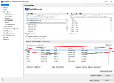

Step 1: Move the SDRAM to first place;

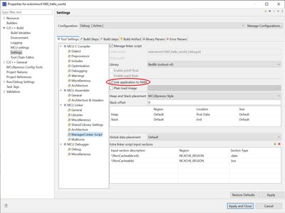

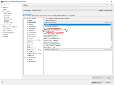

Step2:Make sure the two macros mentioned in the guide are correct, and check the "link to ram" box;

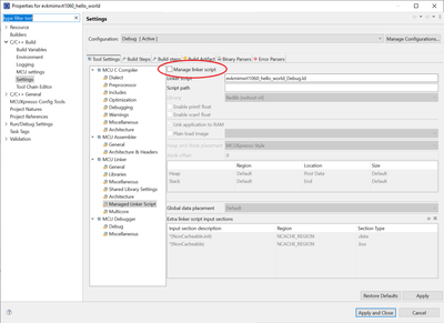

Step3:Apply the above changes and do the first build; the ld script can only be modified after the build is complete.

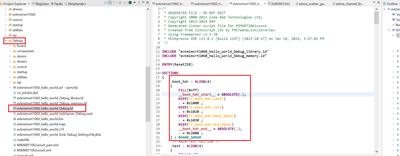

Step4: Find the ld script and add the padding header;
Step5:deselect “Manage linker script” in last screenshot. Then you can build again(the second time).

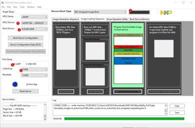

Step 6: The last thing is to generate the s19 file and download the IMAGE using MCUBootUtilitiy;
Note:With this method, there is no need to run "Device Configuration Data" in MCUBootUtility, otherwise it would be a duplicate. However, if you choose the second method to add the header in MCUBootUtility, you need to modify the MCU Memory Map in IDE with appropriate offset.
