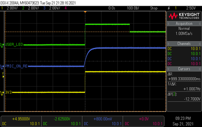

On the i.MX RT1064 EVK, using the demo blinky application (SDK v2.8.6) with MCUXpresso v11.2.1, we see that if we measure the 3v3 and PMIC_ON_REQ until the LED is actually set, it takes about ~270ms.
Using the switch to do a POR, this is almost instant.
What is taking so long to get to the application? Can this time be reduced? Are there settings in the DCD that can be tweaked?
Attached is a screenshot from our scope.
Thanks in advance,
Pieter

I also performed some tests with the Zephyr Blinky App loaded on the RT1064 EVK running v2.7.0-rc4. I timed from DCDC_3V3 to the LED blinking (cold boot case) was 274ms and from POR_B to LED blinking (reset case) was only 16ms, which is similar to what you got.
I did some research and found that the reason that the cold boot takes so long, is due to a voltage supervisor chip on our EVKs (labeled U2) part number UM803RS. This chip holds the POR_B signal low for a minimum of 140 ms from the time DCDC_3v3 reaches the minimum threshold voltage.
The EVK is designed to be overly conservative with this. There are power-up sequencing requirements even without the voltage supervisor. If the on-chip DCDC is used, you need at least 1ms delay from when the DCDC input voltage is stable to starting up the DCDC. And then the DCDC also has a startup time. So it's not possible to completely eliminate the power-sequencing time. The chip will have voltage monitors of it's own, to prevent the POR_B signal from being asserted internally (so you can't see it on the outside pin).
The external voltage supervisor could be removed in your custom design if desired, which would likely reduce the power-sequencing time. Just make sure to evaluate the rest of your power-sequencing needs, in case you have other power supplies that need a longer time to get up and running.
Hope this helps provide some closure and solution to the issue.
-Manuel

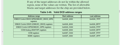

Do you try to modify the flexspi frequency to higher?
About the DCD, the supported register is:
You can find the GPIO is not in the support register.
You also can put your GPIO pull-down code in this API:SystemInit, after the watchdog disabled code, this will be executed after enter the app reset handler.
Kerry

DCD normally used for the SEMC interface configuration for the external SDRAM initialize.

For the DCD you mentioned external SDRAM, can this be left out as we don't need this on our custom board. Won't this speed up the boot process as well?
9,151 Views
kerryzhou
Hi @pdgendt
  If you don't need to use the SDRAM, you can don't configure the DCD, just leave it as default, it's OK.

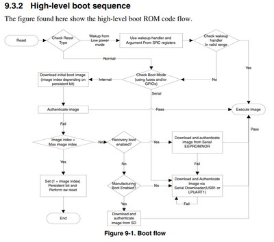

In the reference manual there is this flow:
In the case of a low power wakeup, could the boot time be faster? Where should the wakeup handler be defined?

manuel_pacheco
Hi @pdgendt ,
Please refer to App Note 12085 on how to enable low power on the RT devices:
https://www.nxp.com.cn/docs/en/application-note/AN12085.pdf
You can also see the Power Mode Switch example available in the SDK:
RT 1064 SDK -> demo_apps -> power_mode_switch_bm or power_mode_switch_rtos
I tried to look online, but couldn't find anything on low-power wake-up times on the RT1064, so if you run any tests, please let us know the results.
It seems there's a couple different low-power modes: System Idle, Low Power Idle, Suspend, and SNVS. With each increasing in exit times. Looks like some need to disable some PLLs/Clocks, and gate some of the peripherals.
In the past, I ran a test to determine boot-times with different memories on the RT1050, and I found that they were very close to each other (all ~10ms). So I'm not sure that changing the memory clock speed or changing which memory you boot from would have much of an impact on your boot time:
https://community.nxp.com/t5/i-MX-RT-Knowledge-Base/Boot-up-times-for-different-memories-on-RT1050/t...
I hope this helps,
-Manuel

kerryzhou
Hi @pdgendt ,
  If it is the wakeup, you will run the code directly.
But the first time you still need to run the app code which let the chip enter the low power mode.
 To some low power mode, not the reset wakeup, it will run the code after the code which enters the low power directly.
Kerry
