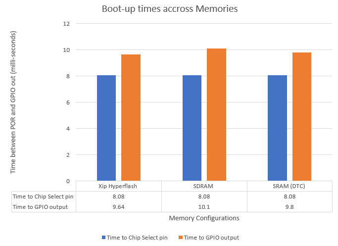

Results
The time to chip select pin represents the moment when the first flash read happens from the RT1050 processor. The time to GPIO output represents the boot-up time.
As expected, XiP Hyperflash boots faster than other memories. SRAM and SDRAM memories must copy to executable memory before executing which will take more time and therefore boot slower.
In the sections below, a more thorough explanation is provided of how these tests were ran and why Hyperflash XiP is expected to be the fastest.

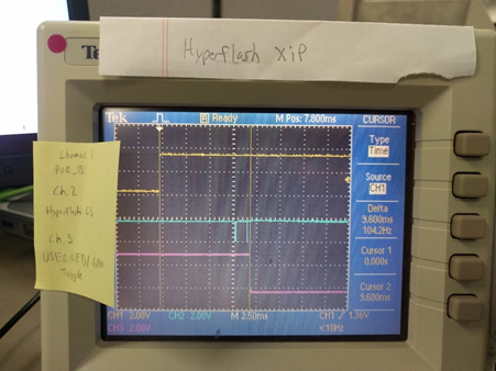

Hyperflash XiP Boot Up
Below is an outline of the steps of what we expect the Hyperflash XiP boot-up process to look like:
  1. Power On Reset (J26-1)
  2. Begin access to Flash memory (FlexSPI_SS0)
  3. Execute in place in flash (XiP)
  4. First line of code is exectuted (USER_LED)
In MCUXpresso, the map file showed the following:
The oscilloscope image is below:

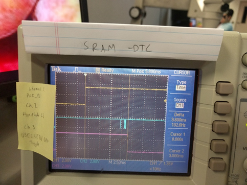

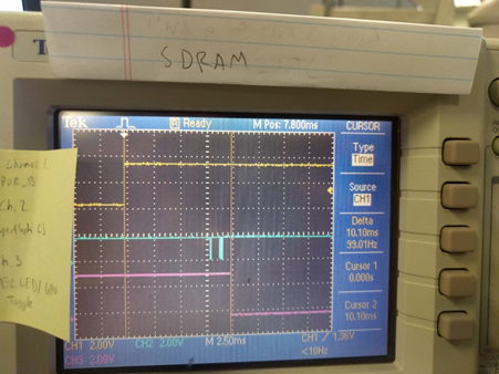

SDRAM Boot Up
The processor will bootup from ROM, which will be told to copy an application image from the serial NOR flash memory to SDRAM (serial NOR flash uses Hyperflash communication). The RT flashloader tool will let me load up the application to the flash to be configured to copy over memory to the SDRAM and execute to it.
It is expected that copying to SDRAM will be slower than executing in place from Hyperflash since an entire copying action must take place.
The SDRAM boot-up process looks like the following:
  3. Copy code to SDRAM
  4. Execute in place in SDRAM (FlexSPI_SS0)
  5. First line of code is executed (USER_LED)

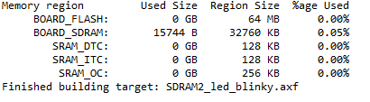

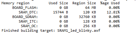

SRAM Boot Up
For SRAM, a similar process to that of SDRAM is expected. The processor will first boot from internal ROM, and then go to Hyperflash. It will then copy over everything from Hyperflash to internal SRAM DTC memory and then execute from there.
The SRAM Boot Up Process follows as such:
  3. Copy code to SRAM
  4. Execute in place in SRAM (FlexSPI_SS0)
