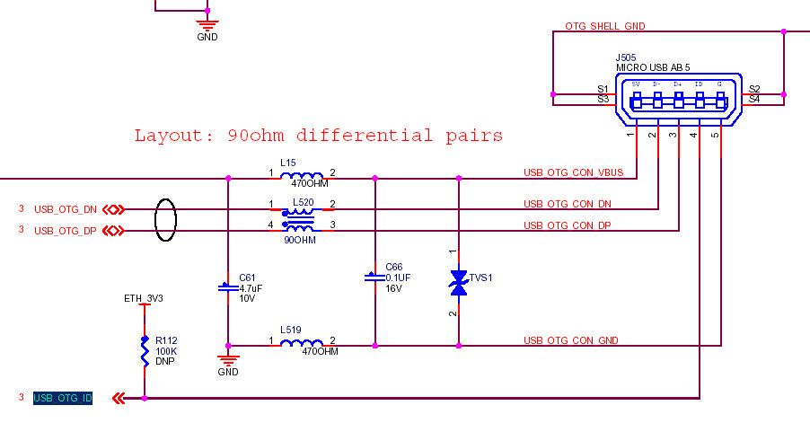

Hello All,
I have configured the u-boot 2013.04 to detect USB at u-boot. I am getting the following logs,
U-Boot > usb start
(Re)start USB...
USB0:   USB EHCI 1.00
scanning bus 0 for devices... 1 USB Device(s) found
       scanning usb for storage devices... 0 Storage Device(s) found
       scanning usb for ethernet devices... 0 Ethernet Device(s) found
Even though there is a USB i can't access it. Please let me know if anybody has had this issue and please reply ASAP.
The most important thing is this port is USB OTG.

Hello All,
The issue was power sequence in module in which PMIC PFUZE100 chip had to be powered on (connected by i2c lines), before checking for USB.
It is purely power issue. If power is not proper to USB, the above issue arises. that is the reason why i never faced the above problem when i did a soft "reboot" but on hard power off and on this issue was seen every time.
That was my final conclusion. Thank you all for helping out. Specially igorpadykov.

manjunathjoshi
Contributor V
Hello Igor,
This issue is not solved.
I have tried using debug prints and below are the logs,

Above logs are for successful usb detection. But the problem is next time when i use the same pendrive, i am unable to get the usb working.

manjunathjoshi
Contributor V
Hello Igor,
Thanks for your replies. Now i am able to detect and boot from USB.
But only the first time usb is detected. Second time when it boots there is an error. Have you seen this error before,

manjunathjoshi
Contributor V
Hello igorpadykov,
If i do fatls usb 0:1 i am getting,
U-Boot > fatls usb 0:1
** Bad device usb 0 **
Meanwhile the USB is not blinking.
5,940件の閲覧回数
igorpadykov
if usb otg is used please check that ID signal
is grounded.
~igor
5,940件の閲覧回数
manjunathjoshi
Contributor V
Hello igorpadykov,
I am really sorry, but i didn't get what is ID signal ?
Manju
