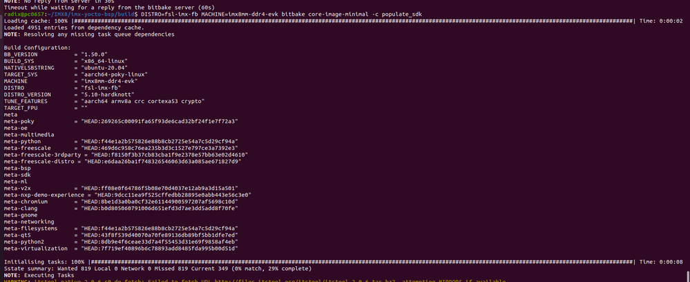

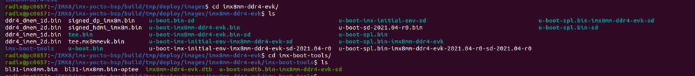

I Am Using Following Step And Generate Image Screenshot from 2022-01-04 09-56-36.pngScreenshot from 2022-01-04 09-56-36.png
Image List:-
Screenshot from 2022-01-04 09-56-43.pngScreenshot from 2022-01-04 09-56-43.png
I Want To Boot A Board Using SD Card So, What Image File should i Use?

Yuri
@Nirjul_Patel
   hardly it is good idea to use i.MX 6ULL configuration for i.MX8Mm.
Yuri.

Yuri
@Nirjul_Patel
   the SPL is default U-boot configuration option for i.MX8M.
Use Chapter 3 (Porting U-Boot) of "i.MX Porting Guide" how to build new
U-boot.
 Generally customers can just to re-write new U-boot  in SD card (.wic)
image. To burn the boot image to the SD card, execute the following command:
dd if=<boot_image> of=/dev/sd<x> bs=1k seek=<offset> conv=fsync
offset is: 33 - for  i.MX 8M Quad, i.MX 8M Mini.
Yuri.

Yuri
@Nirjul_Patel
    According to section 4.1.1 (Bootloader) of “IMX_LINUX_USERS_GUIDE.pdf”:
   The pre-built or Yocto project default bootloader names start with the name of the bootloader followed by the name of the platform and board and followed by the name of the device that this image is configured to boot from: u-boot-[platform][board]_[machine_configuration].bin. If no boot device is specified, it boots from SD/MMC.
   On i.MX 8, the U-Boot cannot boot the device by itself. The i.MX 8 pre-built images or Yocto Project default bootloader is imx-boot for the SD card, which is created by the imx-mkimage.
   On i.MX 8M SoC, the second program loader (SPL) is enabled in U-Boot. SPL is implemented as the first-level bootloader running on TCML (For i.MX 8M Nano and i.MX 8M Plus, the first-level bootloader runs in OCRAM).
 https://www.nxp.com/docs/en/user-guide/IMX_LINUX_USERS_GUIDE.pdf
Summary Page:
 https://www.nxp.com/design/software/embedded-software/i-mx-software/embedded-linux-for-i-mx-applicat...
 UUU is recommended for system deployment; for the recent Linux NXP BSP:
 # This command will be run when i.MX6/7 i.MX8MM, i.MX8MQ
SDP: boot -f imx-boot-imx8mmevk-sd.bin-flash_evk
Yuri.
