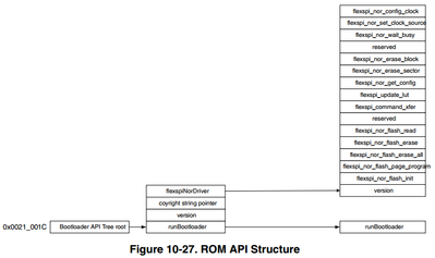

Perhaps my initial post was too specific.  I am mainly just looking for the address of the ROM APIs on the RT1176.   In section 4.5 of the High Assurance Boot Version 4 Application Programming Interface Reference Manual it says:
"The ROM Vector Table consists of a Header followed by a list of addresses as described further below.  For details on the location of the please refer to the System Boot chapter of the relevant NXP processor reference manual."
The only location in noted the RT1170 reference manual is 0x0021_001C but its layout does not match what is described in the HAB API manual, and it only includes the single runBootloader() entry point.
7,405 Views
ericklein
I think I found the answer.  Poking around the ROM, the pointer after the documented address 0x0021_001C, address 0x0021_0020 points to a structure that seems to line up with the documented ROM Vector table (the first byte is 0xDD).  Calling the RVT entries for enter(), get_version(), and report_status() return values that seem to make sense.  However, calling enter() followed by runBootloader() still results in the same hang, so apparently my theory that the ROM was uninitialized was wrong.  It turns out that calling the RVT entry for failsafe() puts me at the same loop as runBootloader, so perhaps I just mis-interpreted what that entry does.  In any case, with this information it looks like I may be able to proceed with updating the fuse shadows and testing the boot process.

jeremyzhou
Thanks for your reply and clarification.
All RT series MCUs only support the below struct of the ROM APIs.
Hope this is clear.
