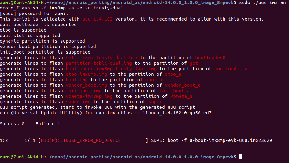

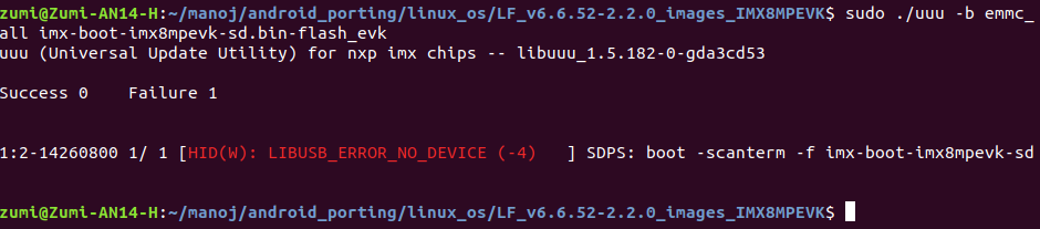

When attempting to reflash the board using prebuilt Linux and Android images (via uuu), we observe the following error, I've attached the screenshot in the document format.

Harvey021
Hi @santhana_kumar
As per communication by email, please be careful about Fuse programming, that is One Time Programming and irreversible operation.
As this SRK hash is the basis for the root of trust. An error in SRK Hash results in a part that does not boot. The failure as re-flashing or boot is expected, when the chip closed.
