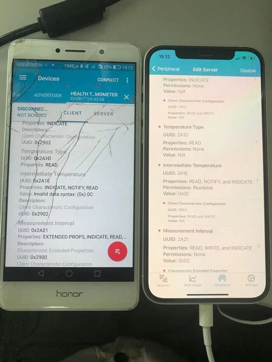

2. About the phone configuration
 From your test result, seems you just add the advertiser, didn't add server. Please check the following picture:
This is my test result:
You can find the RT chip can connect to the peripheral HT from phone, but you may find it didn't get the temperature data.
This is caused by the "nRF Connect"  health thermometer service, as the intermediate Temperture even select NOTIFY, but it didn't works, so I think the app has the NOTIFY function limit.
As I also use another phone which work as the central role,  it also can't get the data, then I use read to get the data:
So, my suggest is, if you just want to check the RT BLE central role with phone, you can test the connection, but to the data get, you can add code to read the data instead of the notify.

I was able to test to the point which you have mentioned using my hardware. It was subscribed to the HTS.
Is there any document for me to refer to do the server settings for a particular service?
Also can you throw me some light on the code which I should modify to read the data?
Thanks again for your help.
9,073 次查看
kerryzhou
Hi EmbeddedTech,
   To be honest, I recommend you find an normal bluethooth peripheral for the testing.
   As you know, the heath temp need to use the notify to let the central know the temp data, but the phone side app can't change it automatically, even you use the read to read it, the data is fixed.
   From your test result, you central scan and establish connection are all works, now, it's better to find a normal peripheral for the testing.
