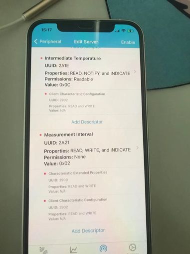

Thank you for the quick response. I have an ios phone and downloaded the 'nRF connect' app. It has the peripheral functionality. I tried running the HT(Health thermometer) Service. I get the following messages in the terminal.
Scanning started
[DEVICE]: 41:84:8D:5E:10:F2 (random), AD evt type 0, AD data len 30, RSSI -47
A Connected to peer: 41:84:8D:5E:10:F2 (random) Found device: ò^
Starting service discovery
Discover complete
Disconnected reason 0x13
It looks like it is connecting to the board but getting disconnected due to timeout.
What could be the reason? Also is it possible to send some default temperature values?
I am using iMXRT1060 EVK + ublox JODY W263-01A module.
Thanks.

kerryzhou
Hi @EmbeddedTech ,
   Thanks for your patient. Also thanks for our my wireless mcu colleague's help (da li) nxf56274
    I already finish the testing, please follow me!
1. app_config.h need to select CM358
/*#define WIFI_BOARD_AW_AM457*/
#define WIFI_BOARD_AW_CM358
//#define K32W061_TRANSCEIVER
2. About the phone configuration
 From your test result, seems you just add the advertiser, didn't add server. Please check the following picture:
This is my test result:
You can find the RT chip can connect to the peripheral HT from phone, but you may find it didn't get the temperature data.
This is caused by the "nRF Connect"  health thermometer service, as the intermediate Temperture even select NOTIFY, but it didn't works, so I think the app has the NOTIFY function limit.
As I also use another phone which work as the central role,  it also can't get the data, then I use read to get the data:
So, my suggest is, if you just want to check the RT BLE central role with phone, you can test the connection, but to the data get, you can add code to read the data instead of the notify.
Anotherway, I suggest you use one of our FRDM-KW38 which works as peripheral HT:
https://www.nxp.com/design/designs/freedom-development-kit-for-kw39-38-37-mcus:FRDM-KW38
Then download the peripheral HT project, it also can works OK with RT+AW_CM358.
This is the test log:
This KW board can help you ack as the periphery for the testing.
Wish it helps you!
Kerry
