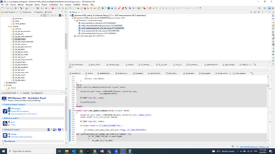

EmbeddedTech
Hi Kerry,
The ublox JODY W263 uses the NXP 8987 chipset, which is same as Azurewave AW-CM358SM.
Please find the sequence in the attached screenshots from the debugger. I am not sure if my understanding is correct. Please clarify.
Thanks.
EmbeddedTech_0-1631677672711.pngEmbeddedTech_0-1631677672711.pngEmbeddedTech_1-1631677704017.pngEmbeddedTech_1-1631677704017.png
