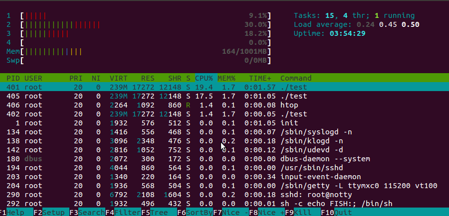

I have embedded device with Freescale I.MX6 SoC.  I compile Qt5.3.1 from source with support OpenGL and when I run my application I have very large use cores of I.MX6 instead use GPU at max. Other more complex animations use core of CPU even greater. Look at the htop screenshot. If I build my QML application for Windows Angle CPU of PC load at 2...3% -  GPU works at maximum.  Does works OpenGLat I.MX6 correctly or for embedded Qt is it normally (i mean great load core CPU)?
The Linux kernel is 3.10.17
Source of test application:

I have a similar problem on my i.core M6 (single core).
If I run a very simple qml "infinite" animation (for example a "spinner" animation or an opacity animation) the cpu temperature reaches the critical threshold (90°C) and then the kernel set the GPU speed to 1/64 until the temperature is lower.
I'm using Qt 5.0.1 and kernel 3.0.35.
Normally the temperature is around 65°C.
How can I solve this problem.?..it seems very strange...

Could you please provide more information on what BSP version you are using. Is it X11 or EGLFS backend?
Tried QML based applications built with Yocto project, and GPU is fully utilized.
Best regards!

My board is var-som-mx6 quadro of the variscite. File system built by buildroot 3.10.17.
Backend is EGLFS. No X11. When I run QML animation I see increase power consumption up to +5 watts. I think this is due to the activation of GPU.
Tell me please how loaded your board cpu cores when you run QML animation?
Best regards!

They have mentioned that on Cinematic Experience is 10 to 20% and wiggly is 12% CPU.

Thank you for your answer. I am sorry but if possible say me - 10...20% is it summary(total) load for CPU(for 4 cores) or load of single core of quadro cores CPU?
5,774 次查看
CarlosCasillas
It is total load (top).

Thank you! It is same as i have. But it is a bit sadly.
5,774 次查看
CarlosCasillas
We are reviewing your request internally, you will get an update soon.
