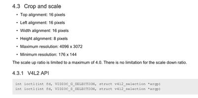

I had the same findings.
I also found the following section that explains that '4' in the zoom:
This is located in the https://www.nxp.com/docs/en/user-guide/iMX8MP_CAMERA_DISPLAY_GUIDE.pdf
@nxp
This also defines the interface to control through an IOCTL call.
Is this API to get the ISP to do the scaling?  Does this happen in the GPU? In Software?
I searched through the i.MX 8M Plus Application Processor Reference manual and I didn't find any reference in the ISP of DEWARP section that  upscale / zoom is a feature.  Those sections do mention downscaling though.
Is the ISP capably of upscaling / zooming digitally?
