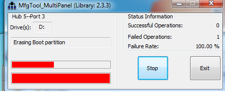

hai  Igor ,
I downloaded android demo-SD-BSP from the above site. and MFG tool from the(android_L5.0.0_1.0.0-ga_tools ) NXP site.
I extracted the android_L5.0.0_1.0.0-ga_full_image_6qsabreauto image and put the images as per the android user guide steps.
I Copied  following files from either release_package/android_L5.0.0_1.0.0-ga_core_image_6qsabreauto.tar.gz or
release_package/android_L5.0.0_1.0.0-ga_full_image_6qsabreauto.tar.gz to the MFGTool-Dir/Profiles/Linux/OS
Firmware/files/android/sabreauto path.
• u-boot-imx6q.imx
• SD/boot-imx6q.img
• SD/system.img
• SD/recovery.img
Change SABRE-AI S3 (boot mode) to 0101 (from 1-4 bit) to enter download mode.
Power on the board. Using USB cable on the SABRE-AI OTG port, connect a computer running Windows OS to the SABRE-AI board.
flashing by using this vb file  mfgtool2-android-mx6q-sabreauto-nand.vbs .
but i get an error like this . please help me to solve this issue.
3,061 Views
igorpadykov
Hi Sachu
had you installed NAND to socket, NAND FLASH is not included with shipped boards.
igor
3,061 Views
sachusanal
Dear Igor ,
I am not installing NAND  on the Socket. is it possible to  install Sd card on the SD socket and flash  mfgtool2-android-mx6q-sabreauto-sdcard.vbs script file.
3,061 Views
igorpadykov
Hi Sachu
yes, possible.
igor
