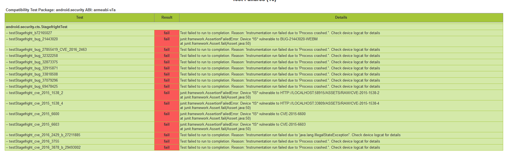

Hi All
The customer run  Android 6.0 CTS will happened security item fail, the fail item as below,
Can you provide patch file or any suggest?
Thanks.

diegoadrian
Which i.MX SOC is using your customer?
Diego

felixhsu
Hi Diego
Use the i.MX6Quad SOC.
Thanks.

diegoadrian
Do you happen to know which Android 6.0 release is your customer using? and also the CTS version?
I believe that upgrading to android O8.0.0_1.0.0_GA may help on this case, looking at the CTS 8.0_r4 test report for i.MX6Q SabreSD the following tests are marked as passed which fails in your customer side.
Hope this can help you.
Diego.
