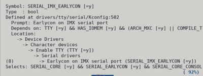

Zhiming_Liu
Try to enable earlyprintk in kernel config  and add earlyprintk in bootargs.
17,214件の閲覧回数
Zhiming_Liu
The bootargs should like this, 0x30860000 is your debug uart base address.
"console=ttymxc0,115200 earlycon=ec_imx6q,0x30860000,115200"
17,210件の閲覧回数
karthick_kkmm__
Hi @Zhiming_Liu
             We have enabled earlyprintk in kernel config (gki_defconfig:-CONFIG_SERIAL_IMX_EARLYCON=y) and added earlyprintk in bootargs (imx8mq-evk.dts:- bootargs = "console=ttymxc0,115200 earlycon=ec_imx6q,0x30860000,115200"). We have attached the output logs here.
17,189件の閲覧回数
