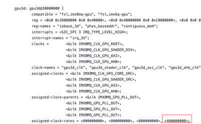

There is no /dev/galcore is detected.  This is the root cause of previous logcat error. What is the difference in galcore on Android 11 an Android 13. We really appreciate on your input on this.

Zhiming_Liu
Hi @karthick_kkmm__
There are lots of differences between Andorid13 and Android11 in galcore source code.
From this log, it seems that the galcore driver has been deferred due to it's resources. Thes resources could relate to hardware or device tree settings.
The gpu3d difference is about the last clock, from 800000000 to 400000000, but i don't think this is root casue.
