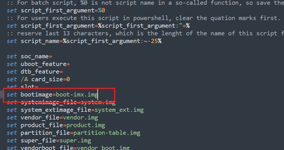

Zhiming_Liu
Hi @dmitry_abdulov
The compile system of Android 11/12 will generate boot.img and boot-imx.img, boot.img includes gki kernel, boot-imx.img doesn't includes gki.
So you can change uuu_imx_android_flash.bat like below.
The version of kernel_imx in Android is same as GKI kernel version, so you will see same version after using boot-imx.img
4,575 Views
dmitry_abdulov
Hi Qmiller,
Thank you very much!!
