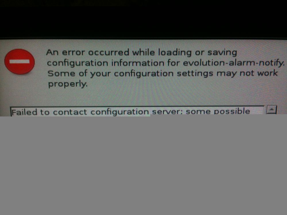

720-IMG_0652.JPG722-IMG_0653.JPGHi!
I have received the iMX53 yesterday. Got the necessary ports connected, and the above error message popped up.
How can I fix it? does this problem commonly occur?
thanks
-Ray

I  realize you would have no way to know the difference since you are new to this, but Ubuntu is a product of Canonical, Freescale just shipped a build for this board. As you can see, the problem has happened on regular PC's as well.
As for officially documented and fixed, it's possible it has been fixed in updates to Lucid, or perhaps this error was caused by some sort of file corruption. I can't say what the cause was. It's never happened to me.

JimDonelson
Ray,
Just for completeness, you:
Rename file ‘saved_state’ to ‘saved_state_old’ in the 'lucid' directory?
Also, the really was a Ubuntu problem, and I don't want others to think that this is the best place to ask this kind of question.
--Jim
4,830 Views
RayL
Hey Jim,
After changing the file names, it works again!
its hidden under home > user > lucid
Gotta click Control + H to show the hidden file.

JimDonelson
See if this helps, there is a link to a solution:
http://ubuntuforums.org/showthread.php?p=8369090
