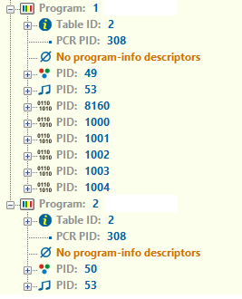

Aiurdemux has a bug where it incorrectly parses the second program in the PMT if it re-uses the same Audio PID that is also in use in the first program, see below. No audio stream is detected for the second program. Unfortunately we are unable to fix this as this parsing is done in the "imx-parser" binary. Is there any way to get access to the source code via a NDA so we can fix it ?

Please contact the local FAE or Marketing for the imx-parser source code request. Thanks.
