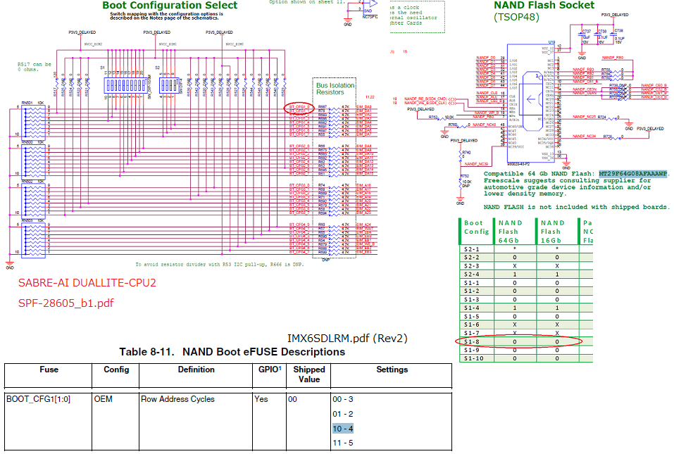

We are going to use i.MX6DualLite.
And NAND Boot is used in our system.
We refer to the schematic of the SABRE-AI board.
  - SABRE-AI-DUALLITE-CPU2
    => SPF-28605_b1.pdf
This schematic assumes that MT29F64G08AFAAAWP is used as NAND Flash device.
According to Boot configuration of SABRE-AI, NAND Row address cycle is set to 4.
  Boot_CFG1[1:0]=10 (Row Address Cycles is 4)
However, Row address cycle of MT29F64G08AFAAAWP is "3".
<MT29F64G08AFAAAWP Datasheet>
http://pdf.datasheet.directory/datasheets-0/micron_technology/MT29F64G08AFAAAWP_A.pdf
I think that the setting of Row address cycle of SABRE-AI does not match MT29F64G08AFAAAWP.
Would you tell me the reason setting Row address cycle to "4" in SABRE-AI?

Actually, setting the Row address cycle number boot parameter larger than the actual Row address cycle number of a NAND Flash device used has no matter for the boot process, since, anyway, all zeros address is latched to a NAND Flash device during initial boot. So, this Row address cycle number setting of 4 has been chosen just for convenience to use single setting for various NAND Flash devices.
