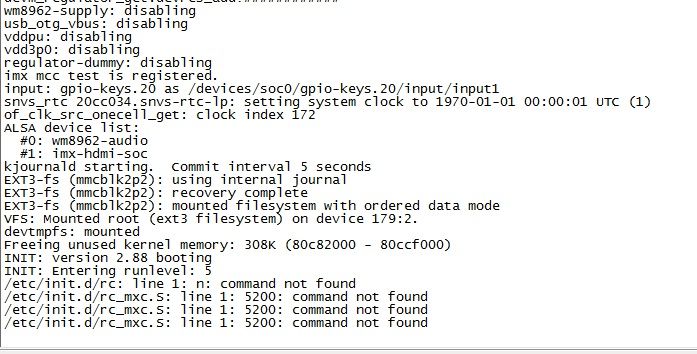

I use linux 3.10 on IMX6Q,but there is problem,the GPU do not initialize success, and the linux can not go to the runlevel 5,and have the problem" /etc/init.d/rc_mxc.s line 1 command line not found".and the  kernel auto into the runlevel 3. The command line the uboot give to the kernel is right.Is GPU initialize failed can caused this problem?22.jpg

please use latest L4.1.15_1.1.0, as it fixed many gpu errata
(one can find description in Release Notes) :

           Thank you respond my problem! The L4.1.15 is the linux 4.1 image ,but I used the IMX6Q's trustzone function, my linux kernel is 3.10,and How can I get the linux 3.10 source that had fixed the gpu errata?
            thank you !
