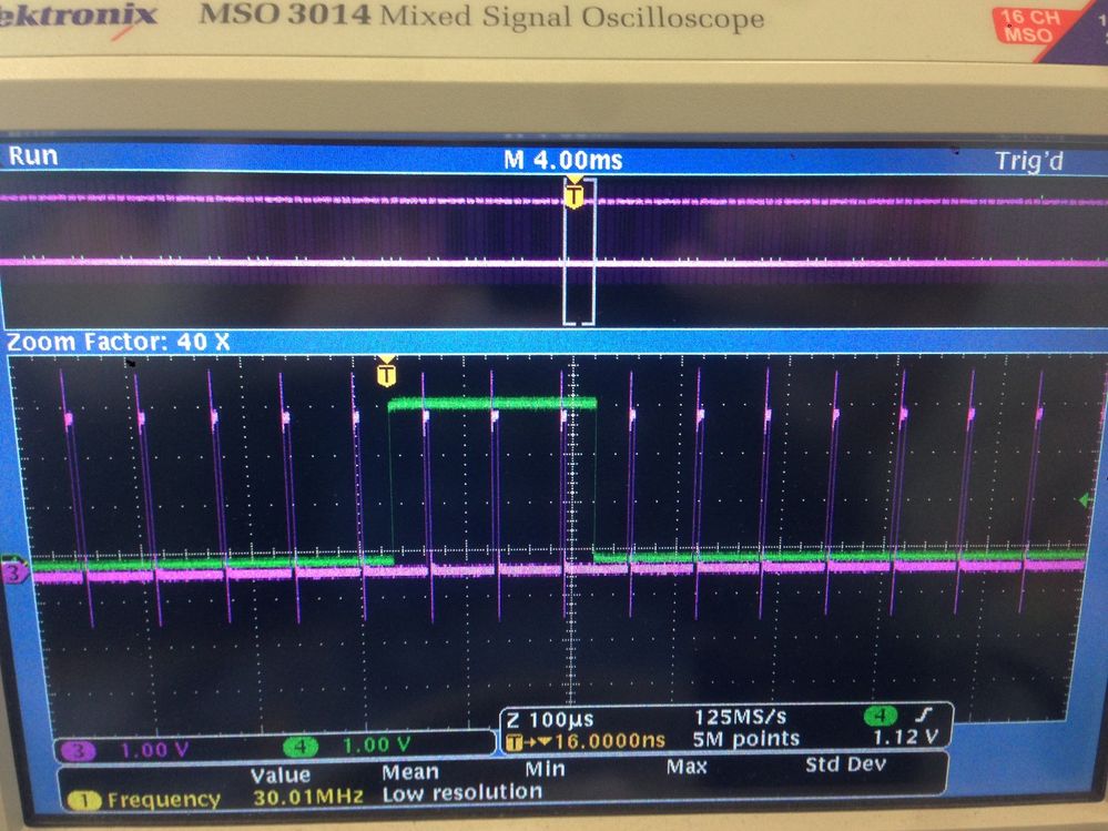

OK, I seem to be able to get data now.  I had to do the following:
1.) Make sure HSYNC and VSYNC were inverted polarity from the ADV7610
2.) Set a clock_curr value in my ioctl_g_ifparm() to !=0
3.) Set bt_sync_correct to 0 in ioctl_g_ifparm()
4.) set sen.pix.priv = 0 in my probe function
I'm now able to get some data into a file using the mfw_v4lsrc gstreamer pipeline, but it is very noisy.  I took a scope grab of the HSYNC (purple) and VSYNC (green).  This does not match the reference manual diagram exactly in that the HSYNC is running when the VSYNC is high, but I can't figure out how to make that not happen.  The clock runs continuously and the data stays low during the blanking period.
Does it matter that the HSYNC continues to run during the VSYNC period?  Should the above waveforms work with the CSI0 input?

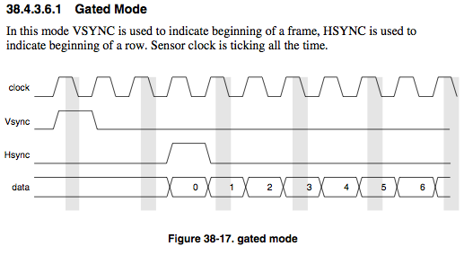

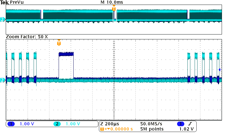

I think I've found why its not working, anyway.  I took a scope trace of an OV camera input from a BD board, shown here:
You can see that the HSYNC (light blue) is inactive for the entire blanking time, and does not run when the VSYNC is active.  This seems to jibe with the IMX6DQCEC:
So it looks like I'll have to try and get the HSYNC/VSYNC signals from my ADV7610 to match up  Unfortunately I'm not sure if this will be possible, as the ADV7610 relies mostly on the DATA_EN pin to specify if data is correct or not.
Is there ANY WAY to make the DATA_EN pin work with the CSI0?
-Allan

allanmatthew
Chip-
Actually, it turns out that turning OFF the DATA_EN seems to work a bit better.  I don't have a correct image yet, but I do have something.  There seems to be an offset in the video, like its starting to read lines in the VSYNC period when it should not be or something.  Is there a crop value or something in the v4l_capture that needs to be set?
-Allan

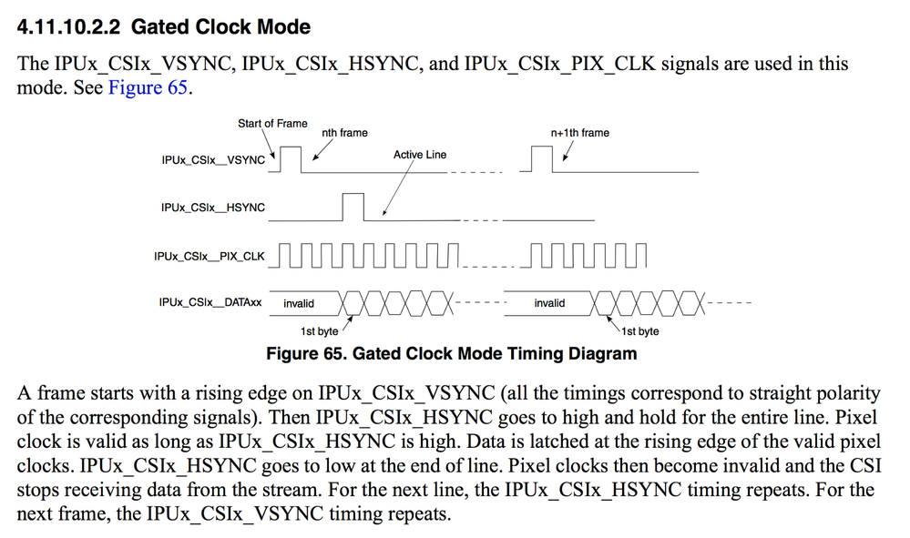

Thanks for the prompt reply.  I tried the mxc_v4l2_tvin.out but no dice, I see the same "ERROR: v4l2 capture: mxc_v4l_dqueue timeout enc_counter 0".
I've done a bit more testing, and here is what I know from the ADV7610 side:
1.) HSYNC is active high
2.) VSYNC is active high
3.) DE is active high
I've checked with a scope and their traces appear (to me) to be correct, however they don't necessarily match the "gated mode" in the i.MX6 reference manual:
My VSYNC will stay high for the entirety of the frame, and the HSYNC stays high for the entirety of the line.  Thats normal operation in my experience, but does the i.MX6 require something different?
Also, there is almost no mention of the DATA_ENABLE line in the reference manual.  Should it be used?  How do I enable it, beyond setting the right pinctl in the DTS?
Lastly, what are the correct settings in the various IOCTLs of my driver to enable the HSYNC/VSYNC/DE modes?
-Allan
