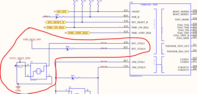

In the 8M Mini datasheet, it specifically says that the 8M Mini must be supplied by an external RTC oscillator, *not* by a crystal. However, Boundary Devices is currently selling an 8M Mini SOM that uses a 32kHz crystal. The Nitrogen8M_Mini SOM uses crystal P/N OM-7604-C7 connected to RTC_XTALI and a 220 ohm resistor going from RTC_XTALO to VDD_SNVS_P8V. Please see attached image for view of the relevant schematic.
Is this another acceptable way to provide an RTC clock to the 8M Mini processor? If so, can you provide reccommended crystal parameters to use?

Hi adevries
 The board is designed by Boundary device, we don't have the reference design. so you will have to contact Boundary device.
In addition, Here Y1 is OSC with 1.8V power, it is not a crystal.
Hope above information is helpful for you!

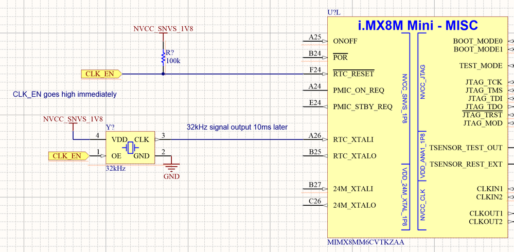

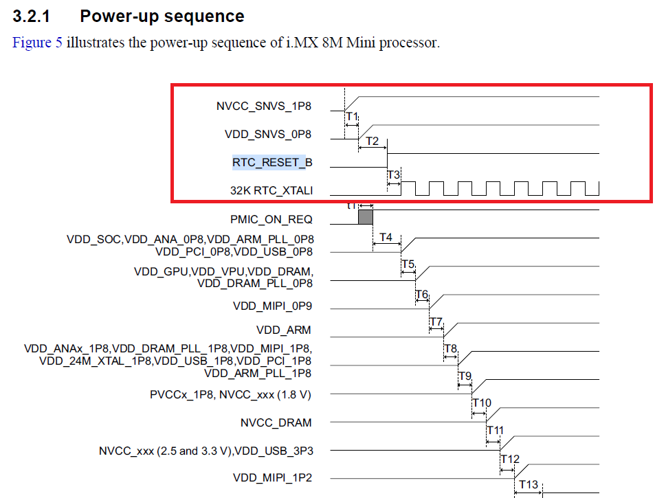

Thanks for pointing that out. When I looked up that part I mistakenly thought it was a crystal, not an oscillator. However, wouldn't that oscillator violate the 8M Mini's power-up sequence? My understanding of the power-up sequence (see attached images) is that the RTC_RESET_B signal must go high no later than 50ms after VDD_SNVS_0P8 starts to power up, and the 32kHz signal must be present 200us before or up to 100us after RTC_RESET_B goes high. The oscillator being used has a maximum start-up time of 500ms, and RTC_RESET_B is simply pulled high when NVCC_SNVS_1P8V turns on. What are the implications of RTC_RESET_B going high so much earlier than the 32kHz signal appearing?

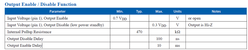

weidong_sun
Hi adevries,
(1) I.MX8MM Power up Sequence
(2) OSC selection
    See the OSC part, please!
OUTPUT EN time is Max 10ms, which can meet requirement.

Hi Weidong,
Thanks for the information. Unfortunately, I don't think that oscillator meets the timing requirements. I need a way for RTC_RESET_B to go high within +100/-200 us from the clock signal starting. If I have an enable signal going to the oscillator and RTC_RESET_B, when the signal goes high, RTC_RESET_B will go high and the clock will start as much as 10ms later. This violates the +100/-200 us requirement (T3 in the timing diagram).

Yes, from the schematic, the P/N of the oscillator is OM-7604-C7, and this is the datasheet for it: https://www.mouser.com/datasheet/2/530/OM-7604-C7-1022965.pdf. I was considering using this oscillator with the 8M Mini, but it seems to have the same issue that many oscillators have, it takes up to 500ms for it to start: pastedImage_5.png
Since this violates the processor's requirement of a 32kHz signal within 50ms, I don't want to use this part. I was hoping someone knew of a way to externally provide this 32kHz signal while still following all the timing requirements? Otherwise, do you know what could happen if the 32kHz signal takes longer than 50ms to appear? And what happens if the RTC_RESET_B signal is not de-asserted within +100/-200 us from the clock signal starting?

weidong_sun
Hi adevries,
    The solution of Boundary device has been validated, so OM-7604-C7 for the design is no problem.The better way for your design is to refer to the design files.
     You know, after all power rails of PMIC are stable, global reset( POR_B:Power On Reset) will occur, all modules in processor, including SRTC will be reset.
     After Power On Reset, ROM  in CPU will use the 32K and begin to run code in it. So actually ,As long as 32K is stable after POR and before ROM code runs, system startup will not be a problem.
