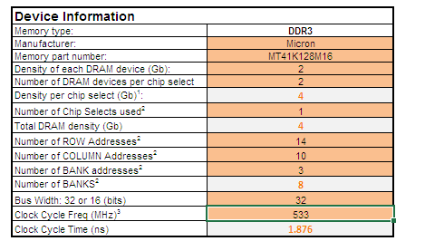

HI,
we have developed a custiom IMX7 Dual with the DDR3 connections and Power supply based on the NXP SabreSD reference design,
we have changed using the excel register aid the script to start the initialization of the device,with the roduced address space of our RAM (2x MT41K128M16), in order to execute the DDR3 stress tool V.2.7.
This are the values from the register aid:
# DDR Controller Registers
# Memory type: DDR3
# Manufacturer: Micron
# Device Part Number: MT41K128M16HA-125:E
# Clock Freq.: 533MHz
# Density per CS in Gb: 4
# Chip Selects used: 1
# Number of Banks: 8
# Row address: 14
# Column address: 10
# Data bus width: 32
# ROW-BANK interleave: DISABLED

The Initial script is downloaded correctly on the device via USB and we are able to read/write registers...
But when we try to do the calibration or the DDR test the software hangs, with all the buttons disabled and no more feedback from the console, in order to try to better investigate the issue we have already checked:
- Schematic and Layout (As in the Sabre SD)
- Power up sequence
- Monitor the status of PLLs via CLK1 output reading and writing registers via the stress tool, and all seems good.
We have leaved, as in the reference design, the poissibility to use double die DDR, connecting the balls J1, J9, L1, L9 on the DDR3 chips, that should be left unconnectes, this could be the root cause for this behaviour?
Looking forward for comments and opinions,
G.

gabrielebettoni
Hello, thanks for the proposal,
I have already used the latest register programming Aid, looking deeper at the problem it seems that the DDR PHY controller doesn't finish the Zq calibration task, debugging using the linux usb loader and trying to modify the DCD table when we ask to check the end of Zq calibration, the check fails:
DATA 4 0x307900c0 0x0e407304
DATA 4 0x307900c0 0x0e447304
DATA 4 0x307900c0 0x0e447306
CHECK_BITS_SET 4 0x307900c4 0x1
What could be the cause of such a problem at this step it could not be related to the RAM external connections of timing, it seems to me that it is something that belongs to the internal DDR PHY.
G.

4,178 Views
gabrielebettoni
Hi Yuri,
the root cause has been found, the JTAG_MOD in our board is configured for Boundary scan access, so it has a pull up.
Changing this pin to a pull down has solved, the stress tool works and pass!!!
Thanks for your support,
