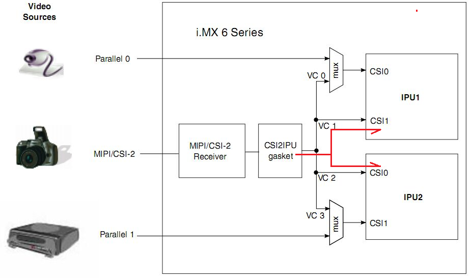

We 'd like to realize real time souround view camera system by using 4 camera.
But i.MX6Q don't have 4 parallel video capture ports. Max 2 only. (=paralle1 and parallel2)
So Can we capture 4 camera signals simultaneously via MIPI-CSI2(4lane) ?
According to the reference manual,  it seem to accept  interleaved 4 streaming video data.
i.MX6Q SABRE-AI have MIPI connector.  We want to make 4 camera extension board use this port.

Hi Kanou,
yes, that should be possible. The MIPI-CSI-2 port knows up to 4 virtual channels. Those can be routed to the two IPU blocks (2 each). You need to make sure that each stream uses a different virtual channel. The IPU has to be set to accept two virtual channels each.
Attached a diagram I drew during a discussion with FIL about this topic. Hope this clarifies the isue. Note that the IPU will take care of converting the incoming format to either RGB8888 or YUV4:4.4 before writing the data into memory.

astraub
all i.MX6 variants should be able to do this. They differ however regarding the maximum bitrate that can be supported
as the Solo/DualLite variants only support two hw lanes.
The MIPI CSI-2 protocol is a packet based protocol (somehow similar to IP). In the headers of the packets is the virtual
channel number (1-4). This has to be inserted by hardware – for example in a FPGA.
The IPU setup certainly is not easy to understand. I attach a slide that might increase the understanding of the basic
principles.
