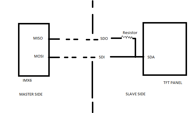

jamesdeepu
Dear Igor,
Is bitbanging required only if MOSI and MISO not connected via resistor ?
My SPI connection is shown below
Here SDO is connected to SDI via resistor on Slave side. Will that work out?.

erezsteinberg
Thanks Igor,
Just to clarify, the support is missing in the Linux driver implementation. It's not a h/w limitation...
(Bit-banging was my backup plan, so i'm not concerned about this too much).
