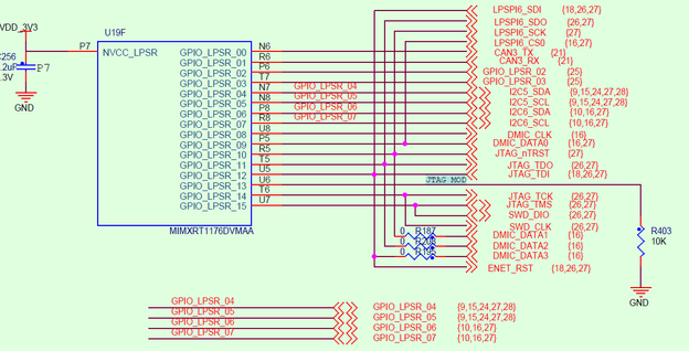

Are you able to share a bit from your RT1170 schematic? I want to check if the JTAG connections meet the recommendations we list on our RT11xx hardware development guide.

Hi Diego - Attached is the schematic and the programming error I see.

What is the termination on the JTAG_MOD pin? So far everything else looks good the other pins from the schematic.

Not sure what you mean about jtag_mod.  There is no mod pin in our schematic.  The true jtag on the 1170evk is J1 on page 27.  It does not have a jtag_mod pin.  We are using the 10-pin version.  The evk has a 20-pin.  Neither has a jtag_mod.  There are 2 reset pins.  trst and  srst

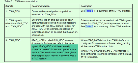

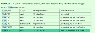

What I mean is that we recommend pulling down with a 4.7K ohm resistor the JTAG_MOD pin, this pin helps to configure JTAG interface in common software debug mode.
See this excerpt from our MIMXRT1170HDUG.
On our EVK we have this pin tied to ground. To narrow down the issue, I suggest you to try to pull down this pin to ground, using a 4.7 K ohm resistor.
See the below image from the EVK schematic.
On a side note. You may see that the value of the RT1170 pull down resistor is 10 K,  this is because  when the board was designed we probably did not have the MIMXRT1170HDUG yet. The values recommended on that guide are the best in terms in design robustness.

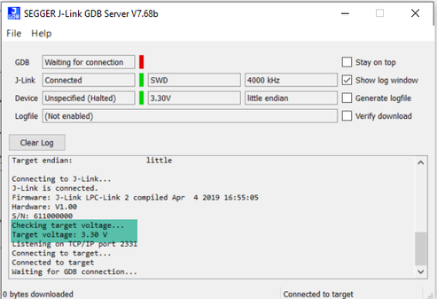

Please with our J-Link firmware loaded into your probe open the GDB server and quickly try to read target voltage. Voltage reading is shown  automatically, after establishing connection.
I will stay tuned to your reply.
Diego.

Here is what I tried.  I don't have a segger debugger ( I did just get one but the cable is wrong).   I put the segger code in the link2.  This came from the lpcscrypt tool.  Did not do anything.  Probe still a cmsis-dap.   Would not connect.  Is that what you wanted.  It will be a day or so for the real segger debugger cable to be made.

After successfully programming the LPC-Link2, make sure to remove JP1  and power cycle. If you where using MCUXpresso, and  leave JP1 , the IDE will soft load  CMSIS DAP automatically.
With Segger what I want to see are two things:
1 Verify that you can connect using this alternative.
2 See if the probe can read target voltage.
Many thanks,
