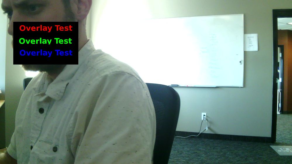

1 frame from input:

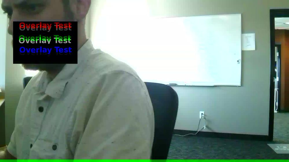

1 frame from output:
You'll notice there's another green bar at the bottom of the screen this time, and something is messed up in the overlay text.

Okay, the issue is the alignment and offsets of the y and uv channels.  I switched the libimxvpuapi2 library for this.
In the encode-example.c code there is a call to fb_metrics = &(ctx->stream_info.frame_encoding_framebuffer_metrics); which returns the y offset, u offset, and v offset that the encoder wants.
My YUV buffer is straight from the IPU, so I assume all of the bytes in the frame are sequential, but the fb_metrics struct is telling me that the VPU needs padding between them...
For example, with a 1080p YUV420 8bit frame...
y_offset = 0; y_size = 1920x1080 = 2073600.  Since the u bytes start right after the y bytes u_offset = 2073600
According to the fb_metrics struct, the encoder *wants* the u offset to be 2088960.
The encoder-example in libimxvpuapi2 uses the y, u, and v offsets in fb_metrics to populate the input dma buffer, but it's just encoding a file, not a live camera feed.
Now...these conversions all work fine at 720p, and when I run the encode-example at 720p, the u_offset/v_offset are exactly as I would expect them to be...
9,791 Views
chrisroed
Turns out libimxvpuai calculates the offsets and strides based on *aligned* frame width/height, not actual frame width/height.  After some searching, I found out according to the alignments, 720p aligns perfectly but 1080p aligns to 1920x1088.  This is the root of the problem.
