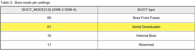

I have a RT1024 EVK which I've been using with MCUXpresso 11.4.0. I have not been able to debug anything - I get a popup saying "0 available SWD devices detected - Connect a device and try again". Restarting the board and MCUXpresso does not help. I can't download/debug even programs that used to work. How do I recover?

Please follow these steps to regain control of your board:
  • Import any example of the SDK, I suggest you import the iled_blinky example.
  • Locate SW8 on your board.
  • Change these switches so you can enter to Serial Downloader.
  • Disconnect and connect the power of your board so the changer in SW8 takes effect.
  • Make sure the project you imported does not have any debug configuration, if it has one please delete it.
  • Launch the debug session while you are in Serial Downloader.
  • Stop the debug session.
  • Delete the debug configuration created while you launched this project.
  • Go to your board and change SW8 the way it was.
  • Disconnect and connect your board.
  • At this point, you should be able to debug without any problem.

Hi Omar, I had the same problem (I also changed the RT1024 !!!) and thanks to this post I solved the problem.
The questions are:
1- What is the status of the RT1024 ? It disables the SWD ?
2- How can the RT1024 reach this state ?
3- How that can happen ?
Thanks in advance
