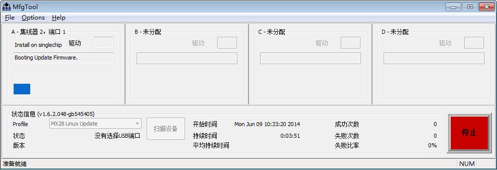

关于imx28 L2.6.35_1.1.0_130130_source 版本 mfgtools 使用 update_ivt.sb 升级失败问题求助
7,122 Views
luoqiaofa
ubuntu 10.10 下安装 IMX28 的LTIB 版本L2.6.35_1.1.0_130130_source 后完全按默认配置编译生成 update_ivt.sb 文件后无法升级,为此尝试多种方法无果,特请社区FSL及其他DX们帮忙, 先谢过
mfgtool 版本为 Mfgtools-Rel-1.6.2.048 , 使用该版本中自带的 updater_ivt.sb 升级则没问题
注: 测试所使用的IMX28目标板为 imx28_evk 板,非我们自己的板
1. 默认 PKG_KERNEL_UPDATER=y 配置时 升级失败的打印log 见文件 Serial-COM10-04241029.txt
Kernel command line: -e console=ttyAM0,115200 rdinit=/linuxrc rw gpmi
Trying to unpack rootfs image as initramfs...
rootfs image is not initramfs (read error); looks like an initrd
Freeing initrd memory: 4096K
RAMDISK: EOF while reading compressed data
uncompression error
VFS: Cannot open root device "(null)" or unknown-block(0,0)
Please append a correct "root=" boot option; here are the available partitions:
1f00           20480 mtdblock0 (driver?)
1f01          241664 mtdblock1 (driver?)
b300         3864576 mmcblk0 driver: mmcblk
  b301          524288 mmcblk0p1
  b302            8192 mmcblk0p2
  b303         3323903 mmcblk0p3
Kernel panic - not syncing: VFS: Unable to mount root fs on unknown-block(0,0)
Backtrace:
[<c002b724>] (dump_backtrace+0x0/0x114) from [<c027e634>] (dump_stack+0x18/0x1c)
r7:c0021a14 r6:00008000 r5:c7c13000 r4:c0325eb8
[<c027e61c>] (dump_stack+0x0/0x1c) from [<c027e698>] (panic+0x60/0xdc)
[<c027e638>] (panic+0x0/0xdc) from [<c0008f9c>] (mount_block_root+0x25c/0x2ac)
r3:00000000 r2:00000000 r1:c7c27f60 r0:c02ccb85
[<c0008d40>] (mount_block_root+0x0/0x2ac) from [<c0009040>] (mount_root+0x54/0x6c)
[<c0008fec>] (mount_root+0x0/0x6c) from [<c00091c4>] (prepare_namespace+0x16c/0x1c4)
r5:c0020940 r4:c0325280
[<c0009058>] (prepare_namespace+0x0/0x1c4) from [<c00084e8>] (kernel_init+0x118/0x158)
r5:c0020940 r4:c0325040
[<c00083d0>] (kernel_init+0x0/0x158) from [<c0044bf8>] (do_exit+0x0/0x5f0)
r5:c00083d0 r4:00000000
mfgtool 的异常为进度图如下
2. 修改内核配置(注:默认PKG_KERNEL_UPDATER=y时,CONFIG_INITRAMFS_SOURCE 为空,即上述情况 ),
CONFIG_INITRAMFS_SOURCE="/home/shltech/Desktop/ltib/initramfs.cpio.gz"
编译生成 updater_ivt.sb后放到mfgtool   相应目录下仍失败.
升级失败时的内核打印见附件  Serial-COM10-04240945.txt
mfgtool 异常进度截图如下
3. 上述问题2中, 若配置 CONFIG_INITRAMFS_SOURCE="/home/shltech/Desktop/ltib/initramfs.cpio.gz" ,则内核会出现
rootfs image is not initramfs (junk in compressed archive); looks like an initrd
但 mfgtool 自带的updater_ivt.sb 则无此行打印,请问这个如何配置?
多谢

PeterChan
Your update_ivt.sb still has problem because unpack rootfs image as initramfs still has error.
Did you build the mx28 mfg updater from a clean LTIB. If no, please install the LTIB to another directory and apply the L2.6.35_130130_mfg_updater.patch.zip only to build the mfgtool updater. It is because the object file dependence imx28 u-boot has problem and object file may not compile when the mx28 u-boot configure option has changed.
Enclosed is the successful boot log.

igorpadykov
Hi, Luo
please look at initramfs patches
i.MX28: Enable initramfs step by step

PeterChan
Please install the BSP to a new folder for mfgtool build. Then apply this patch and try again.
3,053 Views
luoqiaofa
   Hello PeterChan, we followed you steps above, the result is still failed,
  fhe failed log as follows, we don't know what's wrong?  we need your help,
we can make sure the change is ok in dir "ltib/rpm/BUILD/imx-bootlets-src-2.6.35.3-1.1.0" and "ltib/rootfs/boot/updater_ivt.bd"
if you want some code or ltib configurations , pls tell me. thank you
