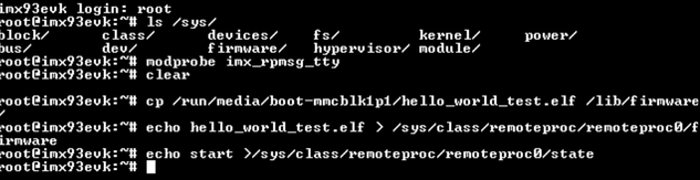

Login with default password "root" and run the following commands to load M33 firmware
$ root
$ modprobe imx_rpmsg_tty
$ cp /run/media/boot-mmcblk1p1/hello_world.elf /lib/firmware/
$ echo hello_world.elf > /sys/class/remoteproc/remoteproc0/firmware
$ echo start >/sys/class/remoteproc/remoteproc0/state
Once done we can verify that the M33 firmware is running on DDR
