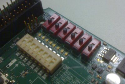

2 - Some hardware configurations (switches) must be done to flash the board.
Set red and cream switches as below:
Switch SW5 -> 000000
Switch SW4 -> 1000000
{{Note|On SW5 and SW4, "1" means the keys selected towards the edge of the board.}

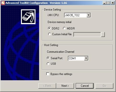

3 - Run ATK (1.6 or above) going to Start -> Programs -> AdvancedToolKit -> AdvancedToolKit
Set the options:
i.MX CPU -> i.MX35_TO2
Device memory -> DDR2;
Custom Initial File -> (keep it unmarked)
Communication Channel -> Serial Port (Usually COM1)
If you are using TO1, Device Memory -> MDDR

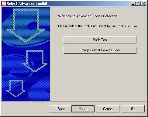

4 - Click on Flash Tools to erase, program or dump the the flash memory and click GO

1- Configure the Dip Switch of Personality Board:
Switch12345678
SW1OFFOFFOFFOFFN/AN/AN/AN/A
SW2ONOFFOFFONONOFFOFFOFF
