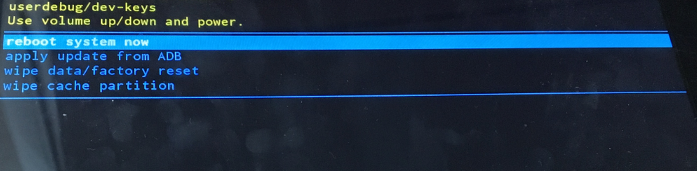

3.2 How do I enter the text menu in recovery mode?
NOTE: This function only works on boards with POWER / VOLUME UP / VOLUME DOWN keys.
  • When the system completes booted up into recovery mode, you will see an Android Robot Logo
  • Press the POWER KEY(keep pressed), and then VOLUME UP KEY going to the text menu like this:
  • Move the menu item by VOLUME UP and VOLUME DOWN button.
  • Select the menu item by Power Key.
  • Select the required option using the direction keys on the keypad or keyboard.
    • reboot system now
    • apply update from ADB, you may update the software from update.zip by adb sideload command. Only NXP i.MX 6/7 series support this feature.
    • wipe data/factory reset. /data and /cache partitions are formatted.
    • wipe cache partition. /cache partition is formatted.
  • Reboot the system.

  • Ensure that the system has entered recovery mode. See "3.1 How do I enter Android Recovery mode manually" section.
  • Toggle the text Menu, move the cursor to "apply update from ADB", the UI is displayed as follows:
  • On your computer, execute below command
adb sideload $YOUR_UPDATE_PACKAGE.zip
  • After the package is sent, the system starts updating the firmware with the update file.
