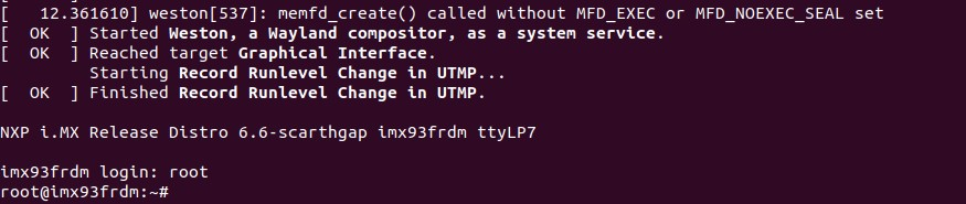

Then build the image that will use LPUART8 as the new console from boot to Linux.
Conclusion.
You have the necessary file list for setting up and using different UARTs as the system console for i.MX 8 and 9 series and you have confirmed it working in any board you have for i.MX 93/91.
Yocto Project knowledge in NXP BSP has been extended from a previous article about patching kernel and drivers to customizing other recipes and what tools are available as their advantages upon different situations [4].
Finally, console access is granted to a new custom board, this is where all debug messages from other codes will be printed.
