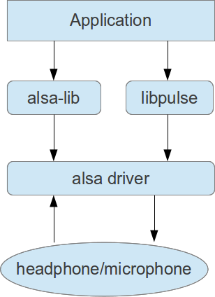

On Linux OS, we have two major audio system API to play/record audio pcm, alsa-lib and pulseaudio. Pulseaudio is in Freescale Ubuntu root fs release, while alsa-lib is used by default in LTIB release.

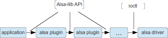

Alsa-lib has a set of standard API which allows application to develop easily. At the same time, it provides a scalable mechanism to fulfill its features, including resample, channels remix, sound mixing from different applications, and so on.
As above figure describes, alsa plugin provide fundamental function, and the whole pipeline makes customization possible.
Alsa-lib API pretend to be an alsa device and provide a name for caller to open. What kind of plugin the name represents for is decided by configuration. For example,

The "!" in "pcm.!default" means forcing overwrite. The pipeline defined above is as following figure:

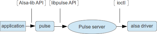

The only alsa plugin is "pulse", and the pipeline is as following:
