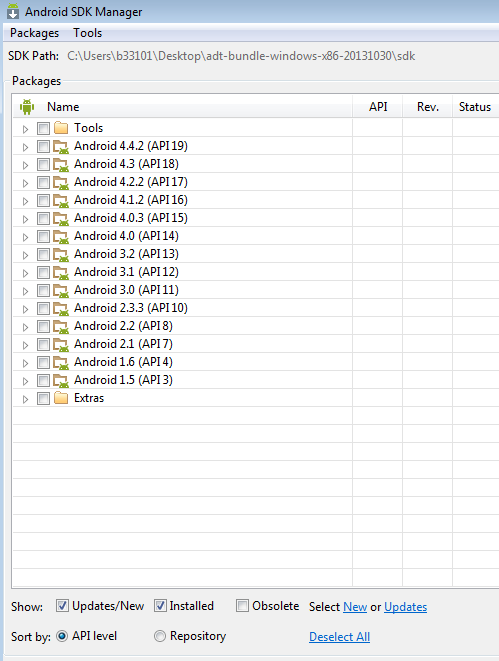

First, you need to have Java and the Android SDK installed on your PC, you can download it from here:
Java SDK: Java SE - Downloads | Oracle Technology Network | Oracle
Android SDK: http://developer.android.com/sdk/index.html
Once it is installed, it is recommended to update the SDK Manager
