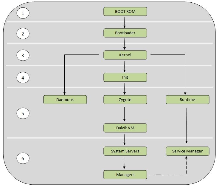

Some questions arise when we think about the Android boot sequence. What is the Zygote, init.rc, what is the difference between the linux kernel and the android linux kernel?.
This document is intended to explain how the booting process runs.
Consider the following graph:
Step 1: Power On and System Startup
When we press the power button, the Boot ROM code starts executing from a pre-defined location which is hardwired in ROM. It loads the Bootloader into RAM and starts executing.

Step 3: Kernel
The Android kernel starts in a similar way as the linux kernel.  As the kernel launches, is starts to setup cache, protected memory, scheduling and loads drivers. When the kernel finishes the system setup, it looks for “init” in the system files.

Step 4: init process
Init is the very first process, we can say it is a root process, or the grandfather of all processes. The init process has two responsibilities.

Step 5: Zygote and Dalvik
In Java, we know that a separate Virtual Machine instance will popup in memory for separate per app, but in the case of Android, the VM should run as quick as possible for an app. But what happens if you have several apps thus launching several instances of the Dalvik (VM)?, it would consume an immense amount of memory.
To overcome this problem, the Android OS has a system called “Zygote”.  The Zygote enables code sharing across the Dalvik VM, achieving a lower memory footprint and minimal startup time.  Zygote is a virtual machine process that starts at system boot. The Zygote preloads and initializes core library classes.

Step 6: System service
After the above steps are completed,  Zygote launches the system services.  The Zygote forks a new process to launch the system services.

Important to understand is the fact that "Android" alone is not entirely an Operating System, it is rather the User Space of Linux Kernel. Android is based on the Linux Operating System, the GNU Linux kernel.
Boot Process is Architecture dependent i.e. X86 and ARM (e.g A8 Cortex) have differences, ARM requires a signed first stage loader so there is a two stage boot process as the article says but does not clearly say its for ARM, Android now runs on x86 as well. If you are interested reading upon the x86 boot process see my white paper: "https://sites.google.com/site/weqaar/Home/files/bootSector_code.pdf?attredirects=0&d=1"

The diagram shows daemons coming off the Kernel which is not entirely true, Kernel processes or Kernel Daemons e.g. kswapd are forked by the Kernel whereas Init forks user-space processes or daemons e.g. ssh
