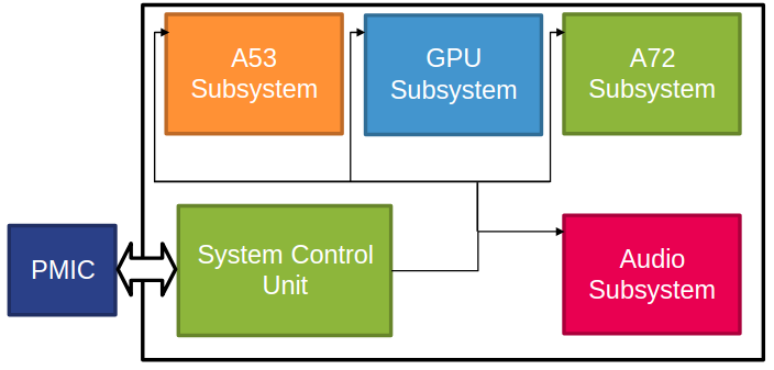

All resources are organized within several subsystems, subsystems group together resources with common functionality. Subsystems are independent of each other and have their own PLLs and power domains, this allows modular control of clocks and power to the resources.
The System Controller Unit has a dedicated I2C channel to interact with the PMIC, this allows dynamic control of some power sources for resources like the GPUs and Cortex-A cores.
The SCU can enable/disable the LDO that supplies power to the GPU for instance and also turn on/off the internal power domains. The mapping of PMIC supplies and resources happens on the board.c (included in the SCFW Porting kit) and it is part of the porting process of the SCFW to new boards.
The function board_get_pmic_info is where the mapping of resources to supplies happen, see:

Only some subsystems have their own dedicated external power supplies, in the example above A cores and GPUs are the only ones with a dedicated external power supplies. Most of the other subsystems are powered from the main power supply and power gating happens internally, each subsystem contains different power domains that can be turned on/off to manage power consumption.

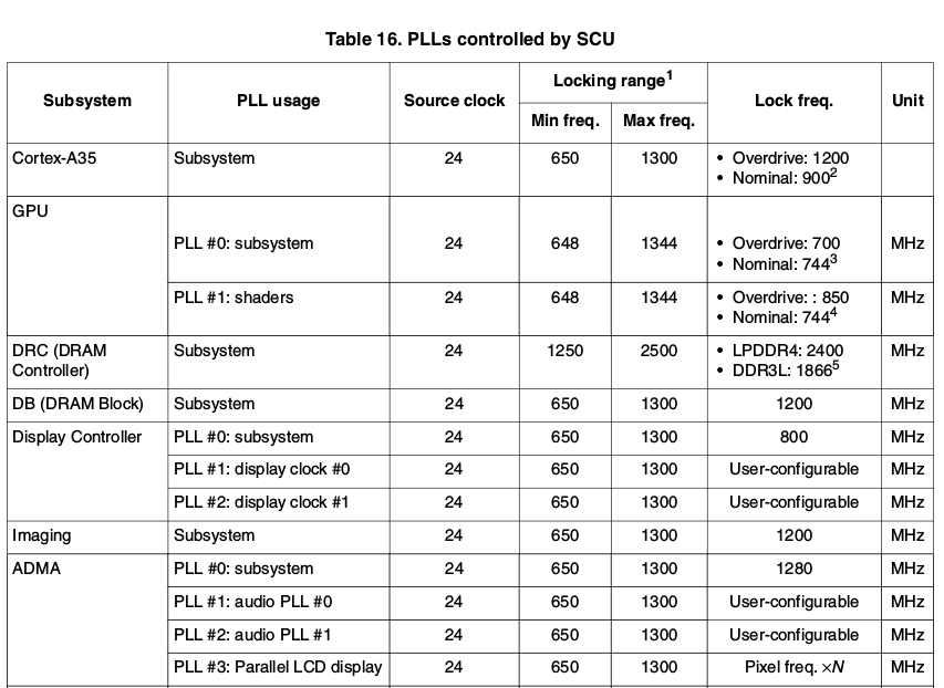

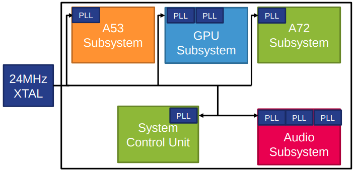

Clocks Configuration
As in the power management case, clocks are also organized in a distributed manner within the device. Each subsystem has it's own PLLs and all of them are clocked by the 24MHz crystal. The number of PLLs in each subsystem varies between all subsystems.
To see how many PLLs are within a subsystem please refer to the datasheet of the device you are interested on.
For instance on the datasheet of the i.MX8QXP on table 16 in Chapter 4.3.1:
It can be seen that the GPU subsystem contains two PLLs, the ADMA subsystem contains 4 PLLs, Display Controller 3, etc...

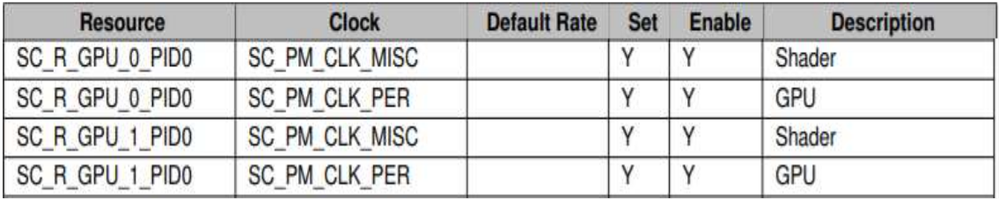

That chapter contains a table with all the different clocks that are configurable by the SCFW, in the case of the GPUs for instance to select the rate for the Shader or GPU, either the SC_PM_CLK_MISC or SC_PM_CLK_PER options would have to be selected.
Set=Y indicates the clock/PLL is not shared and the rate can be set via sc_pm_set_clock_rate().
Enable=Y indicates the clock is not auto gated and must be enabled via sc_pm_clock_enable().
As an example the following snippet configures the GPU_0 shader clock:
sc_clock_rate_t shader_clk=700000000; // 700 MHz
sc_pm_set_clock_rate(ipc, SC_R_GPU_0_PID0, SC_PM_CLK_MISC, &shader_clk);
