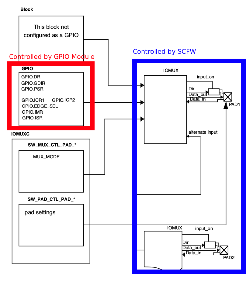

I/O common features
  • Muxing capability of up to 4 signals
Each Pad can have up to 4 signals, only one signal can be present in the pad.

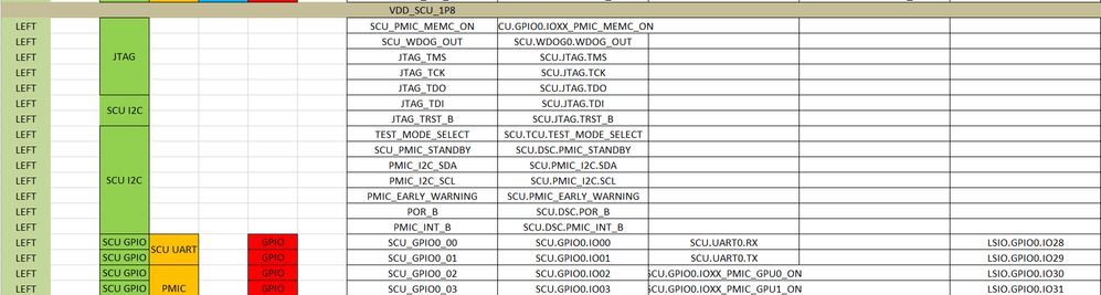

To select the signal that will output on the pad simply look at the Pinmux spreadsheet and use the desired alternative, for instance in the following image SCU_GPIO0_00 has 3 options, SCU_GPIO (ALT0 - GPIO controlled directly by the SCU), SCU_UART0_RX (ALT1 - SCU UART receiver) or LSIO_GPIO0_IO28 (ALT3 - Low speed I/O GPIO).
Pads without GPIO functionality (i.e. without the GPIO option in the pinmux spreadsheet) are implemented for one purpose only, these pins are connected directly to the module that drives them and they feature their own physical interface. Examples are XTAL pins, DDR pins and SCU PMIC interface (shown above).

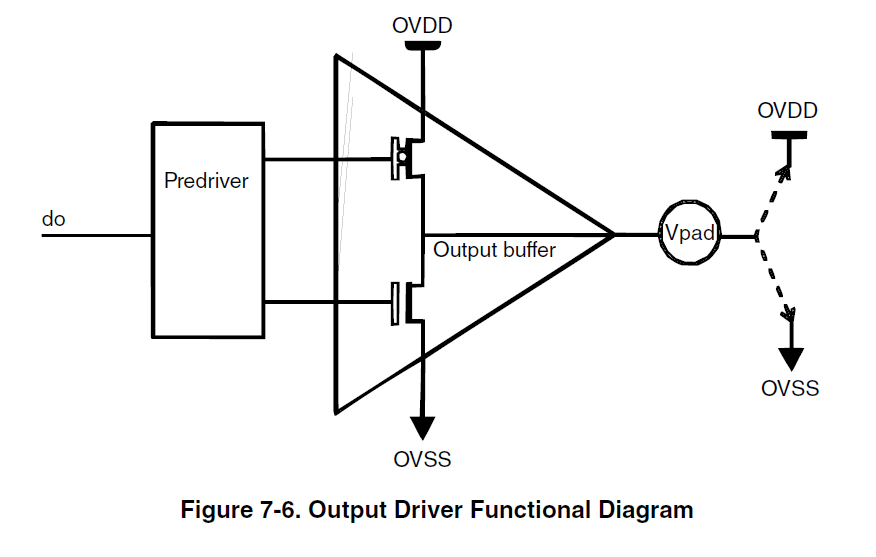

  • Mode of operation
All GPIO types support four modes of operation:
Normal mode
Data is being driven directly to the pad (an internal signal of 1 shows in the pad as a 1 and vice-versa) and the pad works either as an output or as an input but not both at the same time. The output buffer while on this mode looks like this:
Normal.pngOpen drain
Data is being driven through an open drain configuration, the output on the pad switches between 0 and high-z. The pad works either as an output or as an input but not both at the same time, e.g. if the Output Buffer is enabled the Input Buffer is disabled. This is how the output buffer looks like on Open drain mode:
OpenDrain.pngOpen drain and input
Output buffer acts as in open drain mode but with the input buffer enabled regardless of the output buffer state (enabled/disabled), this allows to simultaneously read the signal at the pad while driving it.
Output and input
Output buffer acts as in normal mode but with the input buffer enabled regardless of the output buffer state (enabled/disabled), this allows to read the signal at the pad while driving it.

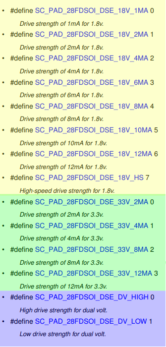

  • Drive strength
Drive strength options vary within I/O types and chip manufacturing options.
The available options for a FDSOI chip are:
1.8V Drive strength options
3.3V Drive strength options
Dual Voltage drive strength options
Drive strength of 1mA
Drive strength of 2mA
Low drive strength (50 ohms)
Drive strength of 4mA
High drive strength (33 ohms)
Drive strength of 8mA
Drive strength of 6mA
Drive strength of 12mA
Drive strength of 10mA
High-speed drive strength

  • dse - The desired drive strength configuration (see Technology specific features above). DSE settings depend on the I/O type being used, the available options for each I/O type are defined under sc_pad_28fdsoi_dse_t:
ENET pads capable of operating at 2.5V are a subset of dual voltage I/Os, the dse options available for these pads are the same as normal dual voltage I/Os. i.e. High drive and low drive.

To determine whether a GPIO pad is 1.8V, 3.3V or Dual Voltage one can look at the pinmux spread sheet, the supply for the pad will indicate what implementation of the GPIO is used. For instance:
  • pads under VDD_SIM_1P8_3P3 are Dual voltage I/Os
  • pads under VDD_SCU_1P8 are 1.8V I/Os
  • pads under VDD_ADC_3P3 are 3.3V I/Os
