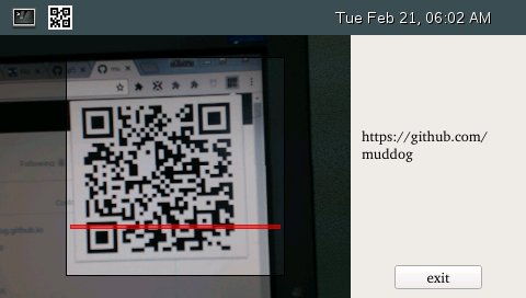

Here I made a QR code scanner demo based on QT5.6 + QZXing (QR/Bar code scan engine) running on the i.MX6UL EVK board with a UVC camera (at least 640x480 resolution is required) and 480x272px LCD.
Source code is open here (License Apache2.0):
https://github.com/muddog/QRScanner

Screenshot under wayland (weston) desktop:
