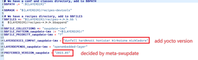

1.2 Modify  Yocto layer
imx-yocto-bsp/sources/meta-swupdate-imx/conf/layer.conf
You can find swupdate version in imx-yocto-bsp/sources/meta-swupdate/recipes-support/swupdate/

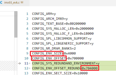

1.3 Handle patches in meta-swupdate-imx/recipes-bsp/u-boot/files/
About patchs in sources/meta-swupdate-imx/recipes-bsp/u-boot/files/ and imx-yocto-bsp/sources/meta-swupdate-imx/recipes-support/swupdate/files/, you need use devtool to unpack uboot and swupdate into workspace and add changes manunally for development.
CONFIG_ENV_OFFSET_REDUND=CONFIG_ENV_OFFSET+CONFIG_ENV_SIZE
sources/meta-swupdate-imx/recipes-bsp/u-boot/u-boot-imx_%.bbappend

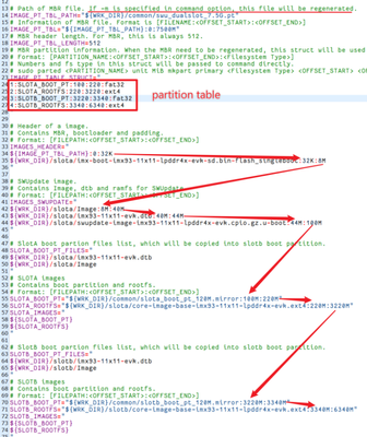

3.1 Partition table
You can modify partition table refer the size of images. For different soc, the first offset is different. If you are porting i.MX8MP based on iMX8MM, the offset should be 32K.
