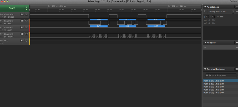

Here is the SPI waveform.  I would like to know why is it "NFCLIB error" after these 0x07 0x12 0x02 SPI commands?  Does it expect something return from MISO line?

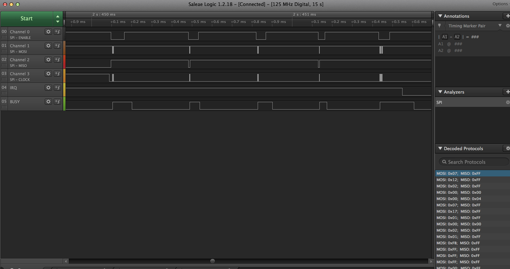

Hi Gideon,
The command 0x7 0x12 0x2 is an EEPROM read access. It means read 2 bytes starting from address 0x12. From the PN5180 manual, we can find that address 0x12 and 0x13 store the firmware major and minor version. It is ok that nothing is on the MISO line, because they library should perform another exchange in order to get the information back.
The SPI enable seems to not be working as the library expects: it is asserted and deasserted for every byte, and in the manual it specifies that the SPI enable must be set to low before a data transaction starts and must be kept low for the whole transaction (no chaining is supported).
Also, the fact that another atempt to perform an exchange and read the response is not performed may indicate a problem with the busy line.
A picture in which the busy line is visible will be really useful.
Dragos
It's working now once I changed the CS pin to other GPIO!  Many thanks Dragos!

As a reference, a good waveform which can successfully init the NFC library and read cards is shown below:
