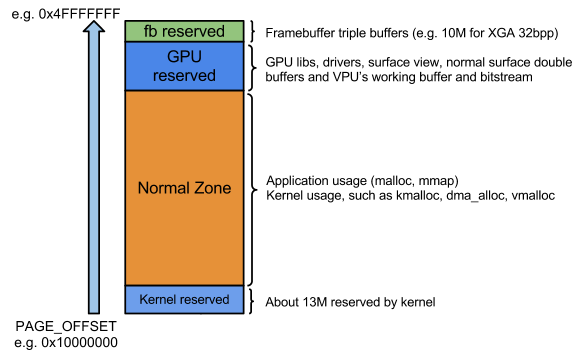

Memory layout
The following diagram shows the default memory usage and layout on i.MX6Q/DL platform.
Memory configuration
According to different type of product and different hardware configurations (ddr size, screen resolution, camera), customer may do some configurations to the memory layout and usage to optimize their system. Some memory reservation can be configured by command line or modifying the code.
  • The kernel reserved space cannot be adjusted. It is controlled by the kernel and the Normal zone size and it depends on the total DDR size and the reserved spaces.
  • Reserved GPU memory size can be adjusted by adding "gpumem=" parameters in kernel commandline. It's size is highly depends on the screen resolution, the video stream decoding requirement and the camera resolution, fps.
gpumem=<size>M
  • Reserved memory size for BG (background) framebuffer can be configured by command line
fbmem=<fb0 size>,<fb2 size>,<fb4 size>,<fb5 size>
For example:
If you have two display devices, one is XGA LVDS, the other is HDMI 1080p device (default 32bpp), you have to specify the BG buffer size for them:
fbmem=10M,24M
The size is calculated by xres*yres*bpp*3:
10M ~= 1024x768x4(32bpp)x3(triple buffer)
24M ~= 1920x1080x4(32bpp)x3(triple buffer)
