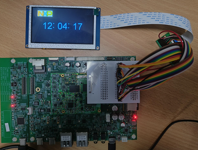

  • Hardware
    • i.MX 93 EVK
    • TFT LCD 480x272 RGB888 (NV3047E, parallel)
  • Condition
    • A55 off
    • DDR self-refresh
    • OCRAM for framebuffer, TCM for code/data
    • LCDIF on with parallel interface
    • M33 update panel content each second
    • 255KB single frame buffer(RGB565) (fit in OCRAM: 0x20480000 ~ 0x204DFFFF)

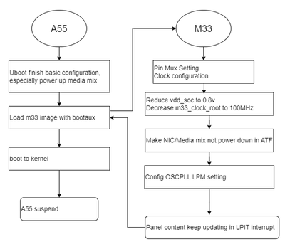

  • Working Flow
  • ​Test Flow
    • In uboot console,
      1. setenv mmcargs $mmcargs clk-imx93.mcore_booted
      2. setenv fdtfile imx93-11x11-evk-lcd_panel.dtb
      3. fatload mmc 1:1 0x80000000 sdk20-app.bin;cp.b 0x80000000 0x201e0000 0x10000;bootaux 0x1ffe0000 0
      4. boot
    • In kernel console,
      1. echo mem > /sys/power/state
      2. start the power test

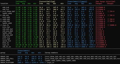

  • Power Consumption
    • SoC power: 94.4mW
    • [email protected]
    • CM33@100MHz
    • CM33@100MHz
    • A55 suspend
    • DDR retention
    • WAKEUPMIX off
    • NICMIX and MEDIAMIX on
