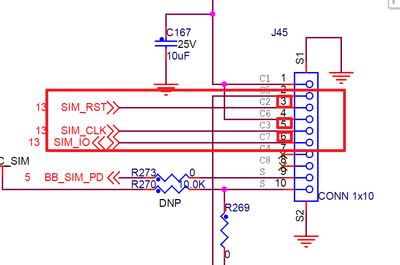

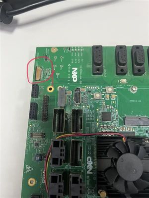

1\ Reproduce on our i.MX8QM EVK board
 a. Check the hardware connection

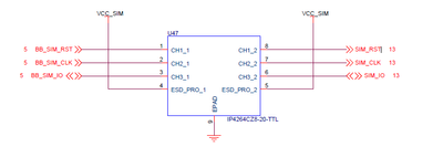

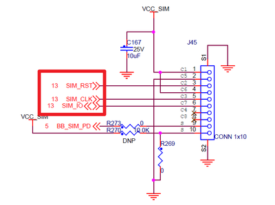

Check the LSIO_GPIO0_IO00 (SIM0_CLK), LSIO_GPIO0_IO01 (SIM0_RST) and LSIO_GPIO0_IO02 (SIM0_IO) connection in our i.MX8QM EVK board.
In the default design in NXP i.MX8QM EVK board, the pins SIM0_CLK, SIM0_RST and SIM0_IO connect to the SIM CARD on the base board.

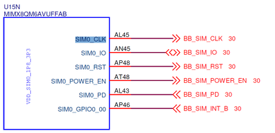

    b. To make these pins work as GPIO pins
In the default pins mux, default pins mux on the SIM0, to make these pins work as GPIO, need to mux them to the GPIO functions.
SIM0_CLK (SIM0_CLK)
SIM0_RST (SIM0_RST)
SIM0_IO (SIM0_IO)

Build the source code, download the images to board, test on the SIM pins to see if these pins can work or not. Test on the J45 pins 3,5,6.

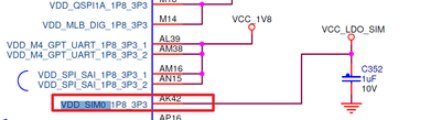

  1. VDD_SIM0 power should be supplied (It is 3.3V on MEK from PF8100 LDO)

2\Make sure the hardware in customer's side VDD_SIM0 power should be supplied .
