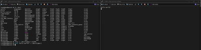

The UART4 on iMX8MM-EVK and iMX8MN-EVK are thinking of debugging the M core which is not usable on Linux user space by default on pre-compiled images.
To use the UART4 on Linux user space you have to do the next modifications on the device tree and atf to assign that peripheral to Linux User Space

After compiling the image with the changes previously shown, we obtained this result:
