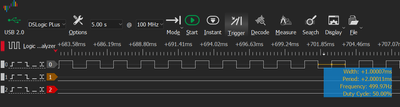

  4.  PWM Configuration on the Board
    After flashing, you can configure the PWM settings on the board. Open a terminal and execute the following commands:
    $ cd /sys/class/pwm/pwmchip1/
    $ echo 0 >> export
    $ echo echo 2000000 >> pwm0/period  # Set period to 2,000,000 ns (2 ms)
    $ echo echo 1000000 >> pwm0/duty_cycle  # Set duty cycle to 1,000,000 ns (1 ms)
    $ echo 1 >> pwm0/enable
  5. Validation

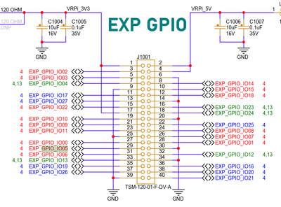

    To validate the PWM output signal, check pin 29 of connector J1001 on the iMX93 EVK Board.

Your example uses the EXP_GPIO_IO05 pin which is available on J1001 connector ( channel 0 of the TPM4).

On iMX93 EVK LPDDR4X, to enable pin EXP_GPIO_IO25 on J1001 connector so it will connect to GPIO_IO25 on the MCU , I configure the ADP5585 IC through i2C interface and set the GPIO 5 output high: on /dev/i2c-1 bus, for device address 0x34, write 0x10 value to register address 0x27, and then write the same 0x10 value to register address 0x23 for the same device address. After those changes you can test with the scope for PWM waves on pin  EXP_GPIO_IO25.
